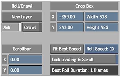

To access the Roll/Crawl menu:
  1. In the Text menu, click Roll/Crawl.
    The Roll/Crawl menu appears.
The Roll/Crawl controls are described as follows.

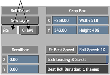

  3. Click Roll/Crawl to enter the Roll/Crawl menu.
  4. Go to the first frame of the clip, and enable Roll or Crawl.

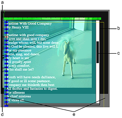

  5. Click New Layer and add the text you want to use for the text roll or crawl.
    A shaded layer appears in the image window with a vertical scrollbar for a roll or a horizontal scrollbar for a crawl. The shaded area represents the crop box area. The following is an example of a text roll.
    (a) Red indicates currently selected paragraph (b) Crop box (c) Scrollbar (d) Blue indicates paragraphs in text roll layer (e) Yellow border delimits text
