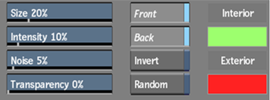

Optics Menu Settings
Optics Node Settings
Size field
Displays the size of the glow effect. Editable.
Intensity field
Displays the intensity level of the glow effect. Editable.
Noise field
Displays the jitter level in the glow effect. Editable.
Transparency field
Displays the transparency level of the front clip. Editable.
Optics Front button
Enable to use the front clip.
Optics Back button
Enable to use the back clip.
Invert button
Enable to invert the matte clip.
Random button
Enable to produce a different glow effect.
Interior colour pot
Select a colour for the interior of the glow effect.
Exterior Colour pot
Select a colour for the exterior of the glow effect.
