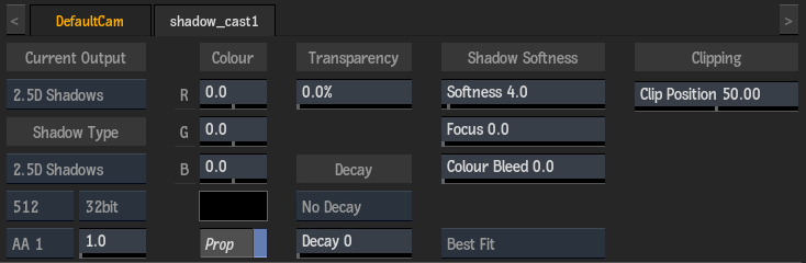

Shadow Cast Menu Settings
The Shadow Cast menu settings are described as follows. Shadow types are dependant on your graphics card, so you may not see all of these settings.

Shadow Type option
Select a mapping type for the shadow. Hard Shadows for high precision, hard edge shadows with penumbra. VSM for dark shadows but imperfect topology, CSM for better topology but with ringing, ESM for deep shadows and better topology but extended penumbra. 2.5D for transparent or semi-transparent objects.

2.5D Shadows 2.5D Shadows work best on transparent or semi-transparent objects, for example a shadow projected on a wall by smoke.
Note: Some of the settings in the Shadow Cast menu differ based on the shadow type you choose.

Red Colour field
Displays the amount of red in the shadow (based on the colour of the attached light).
Green Colour field
Displays the amount of green in the shadow (based on the colour of the attached light).
Blue Colour field
Displays the amount of blue in the shadow (based on the colour of the attached light).
Shadow Colour
Displays the colour of the shadow (based on the colour of the attached light).
Proportional
Enable to change the Red, Green, and Blue colour fields proportionally.
Transparency field
Displays the transparency level of the shadow.
Decay Type option
Select the type of decay to apply to the shadow.
Decay field
Displays the rate at which the shadow decreases for the chosen decay type.
Softness field
Displays the softness of a shadow.
Density field
Displays the level of height/depth discontinuity in a 3D soft shadow. Use to fix light bleeding issues.
Dark Threshold field
Displays the distance of the object from a 3D soft shadow. Use to create a spatial offset, and to remedy step-ladder or levitating problems.
Focus field
Displays the softness of the 2.5D shadow based on the distance from the light. Objects closer to the focus distance are less blurred.
Colour Bleed field
Displays the amount of colour bleed in the 2.5D shadow from semi-transparent objects in the scene.
Flattening Mode option
Select a flattening mode for the 2.5D shadow. Most of the time, Best Fit gives the best quality, but if you see clipping artefacts in the shadow, try one of the other modes.

Clip Position field
Displays the position of the clipping plane for 2.5D shadows, relative to the depth of the shadow. Use to define at what depth the shadow begins to be shown.
