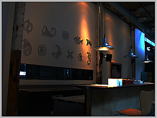

Front view of a 16-bit floating point image

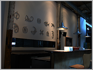

Result view of the image after the exposure and contrast have been modified
