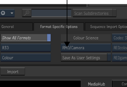

Loading RMD Files from FCP in Flame
Note: The following only applies when using Final Cut Pro X 10.0.8 (or later).
With Final Cut Pro, you can work directly with R3D files, created by RED cameras, instead of using the QuickTime files. This means that when you import a FCP X XML sequence in Flame, you can relink the sequence to the R3D files, providing you with the best image quality.
Another benefit of using the R3D files is the RAW parameters set in Final Cut Pro X are saved by FCP as an RMD file. This file can be read by Flame on import.
To read FCP X Color settings for R3D files, you have to select an RMD option from MediaHub Browse for Files Format Specific Options Colour Settings box for R3D files.
