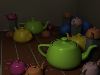

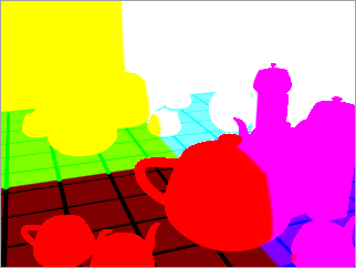

A position map (sometimes called a world position pass), is an image where each pixel's R, G, B colour values represent the x, y, z coordinates of the corresponding vertex, in 3D world space. In Action, a position map works as a type of 3D displacement, that is, it displaces every pixel in that image to the actual location in space of the vertex it represents, allowing you to:
  • Establish depth, position, and scaling in images, for compositing and creative purposes.
  • Relight your scene.
  • Create stereo objects.
  • Creatively transfer the position of one object onto another object.
A typical workflow would be to import (from a 3D application) the beauty pass, the position pass (as a 16-bit floating point OpenEXR clip), the normal pass, and the FBX camera that rendered the scene. Then, apply the position and the normal map to the beauty pass image surface, and set the scale of the position map so that it aligns properly with the 3D camera frustum.
Note: Make sure that your position pass rendering settings in the 3D application are sufficiently high so that the position map displays correctly in Flame. For example, when rendering with Mental Ray in Maya, set the quality level to Production or higher.

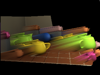

When looked from the original camera POV, your scene looks just like the rendered image. But since pixels are accurately located in space relative to the original 3D scene with the attached position map, you can correctly position 2D layers in the same perspective as objects of the 3D scene.
