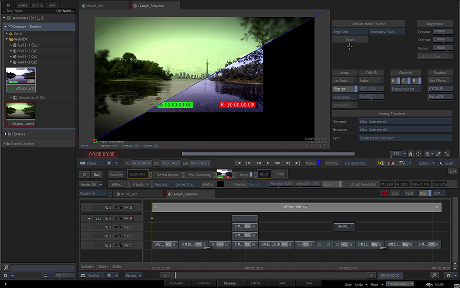

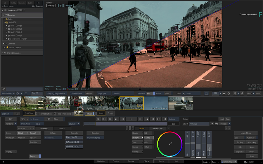

Side-by-side compare everywhere. The Side By Side compare mode is now available in the Batch and the Effects environments. The Select Side by Side Mode keyboard shortcut is also available for the keyboard and Tangent panels but is not assigned.
Cycle Compare. You can now cycle through the Compare modes:
  • Pause/Break on CentOS
  • F15 on macOS
Secondary track compares. You can now set the Secondary Track as the reference with the Compare with Secondary Track keyboard shortcut on a keyboard or a Tangent panel. The shortcut is not assigned.
Improvements to the Compare Mode in the Player
Grab references from the Player. You can now grab a reference from the Player from any compare mode. Use Compare Mode/Stereo Reference box Grab.
Compare to Grabbed References. You can now use grabbed references in the Player. Select a grabbed reference using Compare Mode/Stereo Reference box Grabbed References.
Auto-resize reference. In any Compare mode, a reference automatically resizes to the resolution of the Primary Track. You set the resize method, resize algorithm, ratio option using Compare Mode/Stereo Reference box Edit References Settings .
Setting the Primary Track. You can now use the Reference box to set the Primary and Secondary tracks.
Split Mode Updates
Direct manipulation.You now manipulate the Horizontal, Vertical and Angle Split bar directly in the Player, using the same widgets as the one used in Batch and Effects. Because of this, the Position and Angle numeric fields have been removed.
Reset with a button.You can now reset the position and angle of the Angle Split mode using the Reset button or the Compare: Reset Split Pivot keyboard shortcut (unassigned).
Pivot from the corner.The pivot now defaults to the bottom left of the image in the Player.

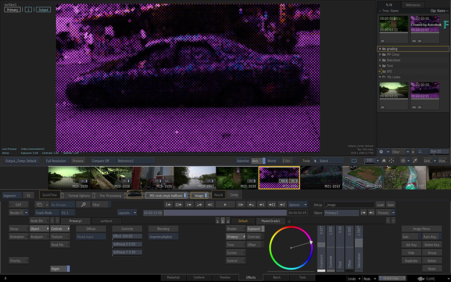

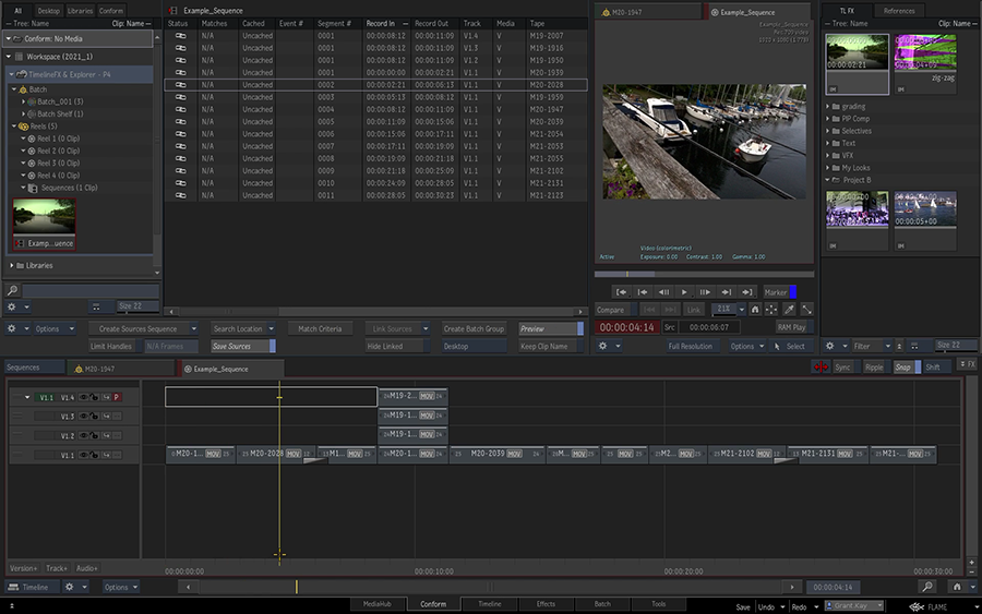

Explorer everywhere. You can now access and use the Explorer in every environment. As a result the following functions have been removed from the Media Panel:
  • The TL FX Tab
  • The Grabbed references Library
Because of space constraints, there are cases where the Explorer cannot be displayed:
  • MediaHub: The Explorer is available only in the Projects and Archives tabs.
  • Conform: On monitors with lower resolutions, the Explorer is not available when the Media Panel is full height and the Preview window is displayed. To display the Explorer, you can hide either one of them or not set the Media Panel to full height.
  • Timeline or Tools: A Player panel (such as the Viewing settings or the Scopes) and the Explorer cannot be both displayed. Hide the Player panel to display the Explorer.
If you have a second monitor, you can display the on that second monitor instead and remove the above restrictions.
Matching selection. Selecting a grabbed reference using the Reference drop-down button also selects it in the References panel of the Explorer.

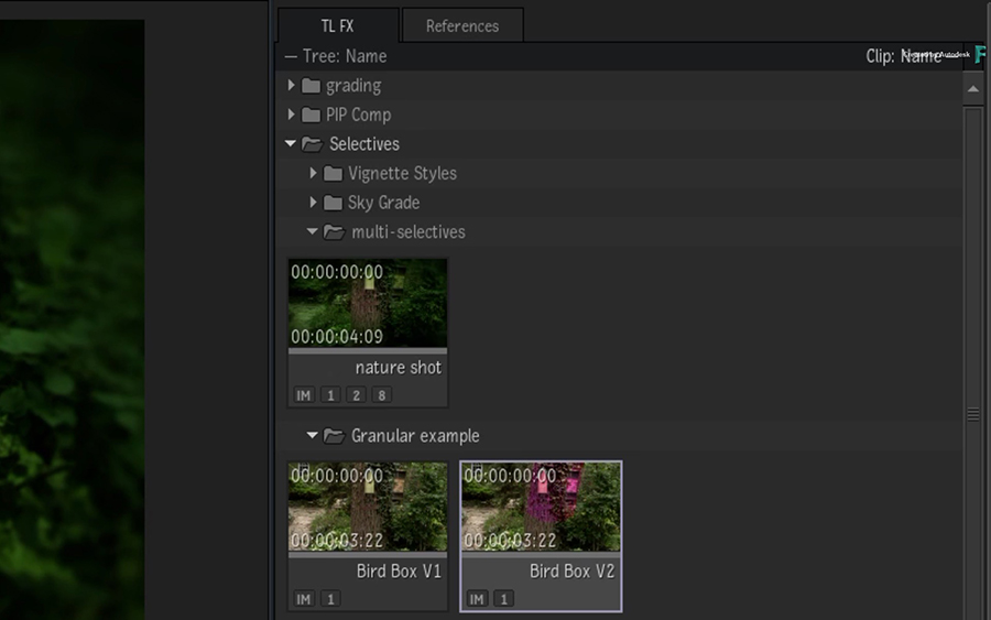

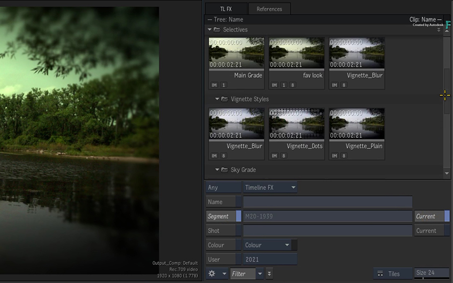

Selectives in Explorer
In the Effects tab, some of the Selective operations have been updated to improve consistency between the Selective Manager and drag & drop workflow.
Modifiers to use when you drag & drop a selective from the Explorer into the viewport or a segment:
  • Replace Selective and Matchbox Shaders: Shift
  • Replace Selective Only: Shift+Alt
  • Replace Matchbox Shaders only: Shift+Command (macOS), Shift+Meta (Linux)
  • Append a Selective with the Ctrl shortcut.
If you do not use the above shortcuts and a selective with the same ID already exists, a dialog window asks you for the operation to perform.
Load with a click. You can now load a Selective setup from the Explorer to the selected segments by double-clicking the Selective setup.
