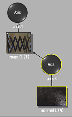

  1. In the schematic, select the surface or 3D geometry to which you want to apply the normal.
  2. Click Media.
  3. In the Media menu, select the media you want to use for the normal.
  4. Do one of the following:
    • Drag the Normal Map node from the node bin and place it in the schematic.
    • Drag the Normal Map node from the node bin and place it where you want it in Result view.
    • Double-click the Normal Map node. You do not need to be in Schematic view to add a node in this manner.
    The normal object is added to the schematic with its own parent axis. The new axis is the child of the selected surface or geometry. In Schematic view, the number in brackets next to the name of the normal node indicates the media used for the normal.
