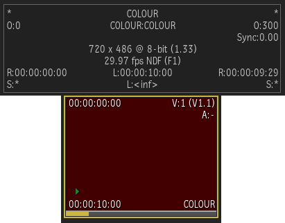

By default, basic metadata such as the current timecode, video and audio tracks, duration, and clip or sequence name are displayed on each corner of a thumbnail. More detailed metadata for each clip or sequence can be viewed directly on the thumbnail clip in the Viewing and Media panels.
To quickly view detailed clip information:
  • In the Viewing or Media panels, position the cursor over a thumbnail.
  • While holding the Alt key, click the thumbnail.
    Detailed clip information appears in the Information window until the Alt key is released.
