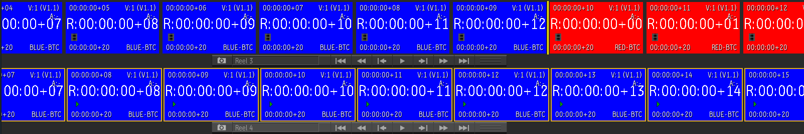

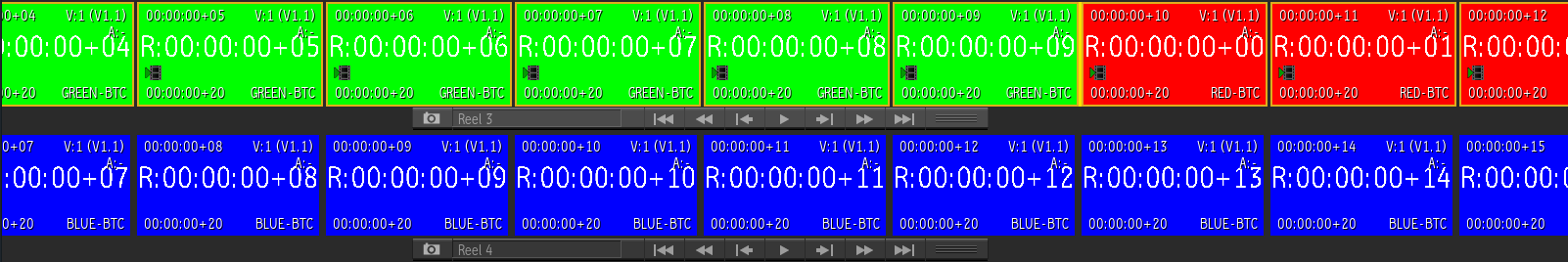

Two clips on the Desktop prior to the Swap Segment operation. In this example, the operation will swap the green segment for the blue clip while aligning frame 8 from the green clip to frame 11 from the blue clip.
After the Swap Segment operation, the green segment has been swapped with the blue clip, while aligning frame 8 from the green clip and frame 11 from the blue clip.
