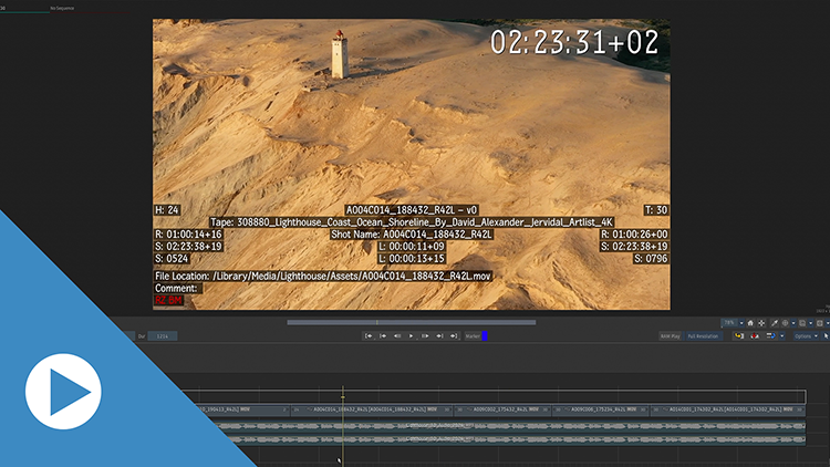

You can overlay clip information (metadata for short) over the image in the Player, in a fashion similar to Burn-in Metadata FX, but without having to manage a Timeline FX on a gap.
Flame Learning Channel: Metadata Overlay
Display the Metadata Overlay using:

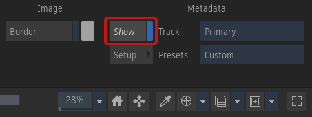

The new Show button in the Player's Show Overlays panel.

Two Metadata Overlays presets are available: Frame and Timecode. They display the same information as the Information window when you Alt+click any clip or segment.

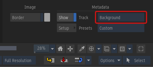

In the Player, you can select the source of the displayed information. This source is either the Primary or the Background track (the lowest track in the timeline). You can set this in the Metadata Overlay Edit Setup, or in the Overlays menu, with the Track box.
