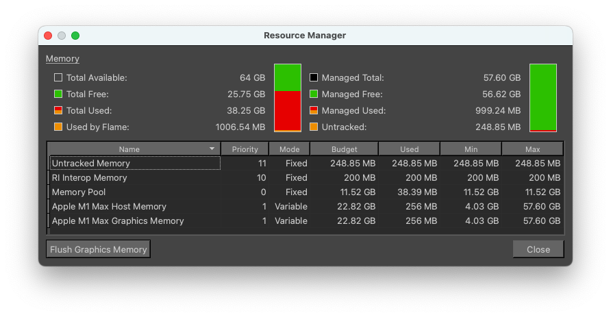

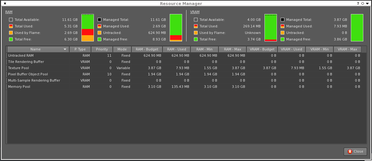

A Resource Manager utility is available from the Flame menu. The Resource manager indicates the amount of RAM and VRAM that are Available, Used by the system, Used by the application, and Free. It also lists the RAM and VRAM clients, and details their memory consumption.
Note: Workstations equipped with Apple Silicon have only one type of resource (Unified Memory Architecture - UMA), but this is not reflected in the Resource Manager dialog.
