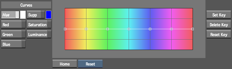

    The Colour menu appears.
    The Colour menu displays colour curves over a hue spectrum. When you modify the shape of a curve over a region of the spectrum, only those colours are affected.
  3. Click Supp to modify the Suppression curve.
  4. The colour pot next to the Suppress button displays the colour that will be suppressed in the clip when you modify the curve. By default, the blue colour is displayed. To change the colour sample, click the colour pot, use the colour picker to sample the colour spill in the image window, and then click the colour pot again.

  7. Use the cursor to move the points along the Suppression curve.
  8. On the Suppression curve, drag the point closest to the plotted colour down to a value of 25, intersecting the plotted colour.
  3. Enable Hue to modify the Hue Shift curve.
