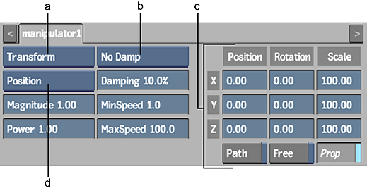

You use the Particle Manipulator menu to select the type of manipulator, its speed and position, and the power of its falloff. To access the Particle Manipulator menu, double-click the particle animator node in the schematic, or follow the tab population rules for the Object menu (see Populating Menu Tabs of Selected Objects).
(a) Manipulator Type option (b) Damping option (c) Axis controls (d) Influence option
Select the type of manipulator.

Influence option
Select whether the manipulator influences each particle's position or speed.

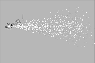

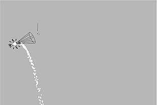

When you influence by position, the position is applied only once. For example, the following figure uses a gravity manipulator to illustrate the difference between position and speed. The gravity manipulator on the left uses the default gravity manipulator with a magnitude of 4 and with position as the influence. The gravity manipulator on the right uses exactly the same settings except the influence is set to speed.

Damping option
Select the type of friction to apply (damping affects the speed of particles by applying friction based on each particle's mass, size, or both).

Axis controls
Use these controls to animate the position, rotation, and scale of the manipulator.
