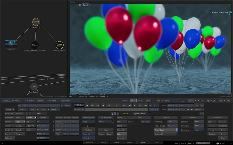

PhysicalDefocus Matchbox
The PhysicalDefocus matchbox completes the previously released Physical Bokeh and Convolve by adding depth support to the same convolution engine.
This node offers two independent Defocus model: a custom one and a physical. The node also offers different ways to set the focus plane, as well as leverages the Action Camera value. Finally, you can use its procedural kernel for the bokeh, provide your custom kernel, or use the PhysicalLensKernel matchbox.

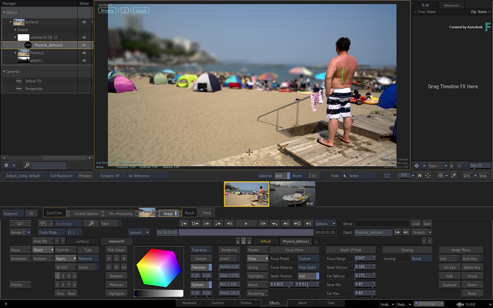

Focus Plane
Focus Model
The Focus model sets the behaviour of PhysicalDefocus. Three behaviours are available: Custom, Physical, and Action Camera. Each option comes with its own set of Depth of Field controls.
Focus Model Options
Custom Use Custom when you want to manually handle the Near and Far defocus levels as separate entities.

Focus Distance
Define how the focus distance is set.
- Action Cam: Set the point of focus. Use the Action Camera Interest value if it is in Target mode. Use the Distance value if it is in Free mode.
- Free: Set the point of focus starting from the camera Z position.
- Pixel Depth: Set the point of focus based on the depth position of the pixel coordinate define by the X and Y values. The pixel depth is computed at each frame, so you must animate it over time.
- Target: Set the focus point through either an expression in the animation channel, or enter the coordinates of the object in the Action scene containing an X, Y, and Z.

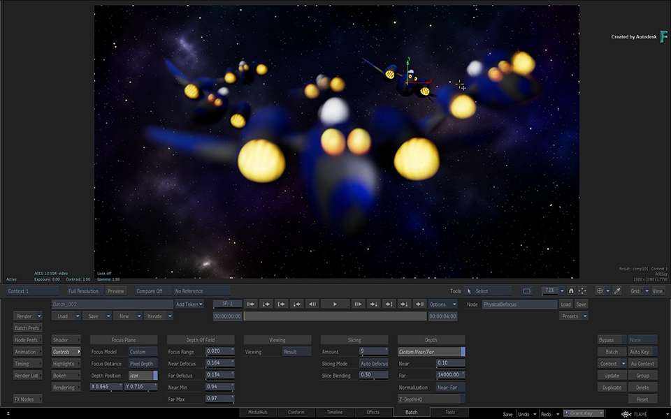

Depth
Physical Defocus requires a normalized depth ranging, where values range from 0.0 to 1.0. A Depth render pass from a renderer other than Action is probably expressed in absolute unit values, and needs to be normalized. Use the Depth controls to normalize the Depth map.
Custom Near/Far
By default, the Near and Far values of the current Camera are used when the effect is used in Action. If they do not match the Depth data, you override it by manually entering the near and far depth values.
You can improve the precision by entering the camera data that was used when the scene was rendered. If that information is missing, use the colour picker and pick the pixels of the Z-Depth map to find the smallest and largest depth values. Enter these values as the Near (smallest) and the Far (largest) values.
Normalization
- None: The default option. If you are using the Z-Depth render pass generated by the Action node or any other renderer generating normalized depth, use None: it does not apply any normalization.
- Inverse: Use if the renderer creates a normalized inverse depth where a white value of 1.0 represents the closest distance to the camera and black at 0.0 the farthest distance from the camera.
- Near-Far: The renderer outputs a Z-Depth expressed in units from the point of view of the camera. This type of Z-Depth map always appears as white frames: 1.0 represents a single unit of distance from the camera. Use the Near/Far fields below to match as closely as possible the depth range to maximize the depth precision. This is the type of Z data generated by the Arnold renderer.
- Far-Near: The inverse of the Near-Far option.
- Min-Max: Automatically map the minimum and maximum colour values to the normalized 0.0-1.0 range. However, this mapping is done for every frame and can lead to discrepancies in the Focus Plane between frames. If you use this option you might have to animate the Focus Plane.
- Max-Min: The inverse of the Min-Max option.
Z-Depth HQ
Z-Depth is much more precise in 32-bit precision. If for performance reasons you do not want to switch to 32-bit Action Rendering, enable Z-Depth HQ Action output pass instead, which is encoding 32-bit precision in 16-bit file format.
