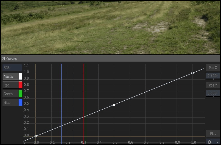

Curves Improvements
In addition to the Add Points mode, you can now add points with a colour picker.
  1. Click Plot.
  2. Click and hold on the image to display the Colour Sampler.
  3. Scan the image for the right pixel. See in the Curves graph the sampling lines that indicate the current RGB values.
  4. Release the pointer to plot the RGB values of the pixel on the Curves graph. This adds points to the curves where the sampling lines are.
Tip: You can also define a keyboard shortcut. Search for Plot Pixel Colour in the Keyboard Shortcut Editor.
To see the sampling lines: Click and select Show Colour Samplers.
