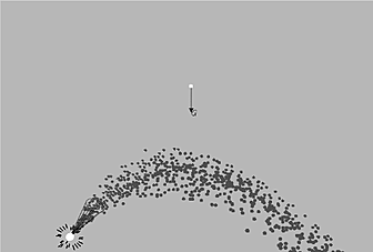

The following figure provides an example of creating a simple particle stream influenced by the gravity manipulator. The settings in the Particle Manipulator menu and the resulting effect are shown.
