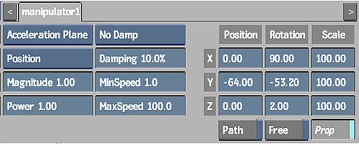

Use the Axis controls to position the Acceleration Plane manipulator in the scene. The Scale and fields are not used.
Magnitude is the gravitational pull in pixels per frame. A higher magnitude produces a higher gravity, which results in a greater influence. Power is the falloff from the manipulator, or the radius, of the pull.

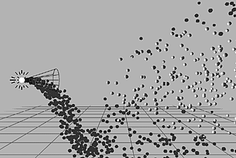

The following figure provides an example of creating a simple particle stream influenced by the Acceleration Plane manipulator. The settings in the Particle Manipulator menu and the resulting effect are shown.
