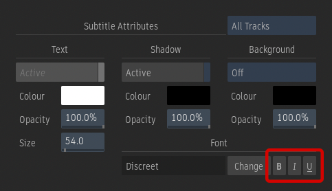

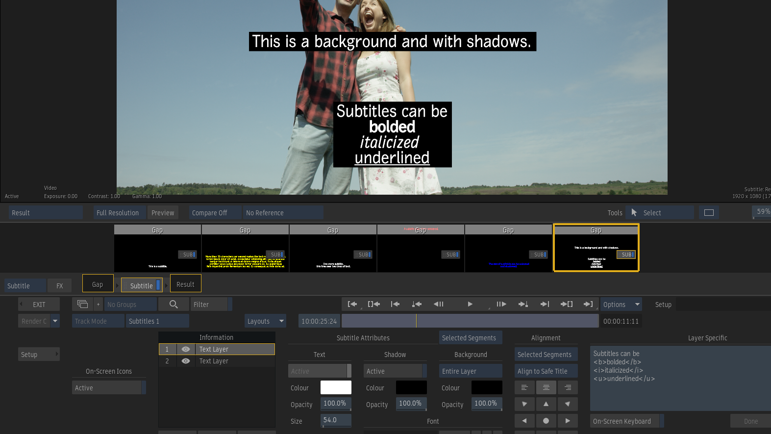

You can set text to bold, italic, and Underline. Contrary to other attribute settings, this can be set per character in a layer.
  1. To set a character, word, or layer to bold, italic, and Underline:
  2. Select the text in the Text field.
  3. Click B, I, or U to apply the style.
When you apply a style, its tag is added to the text.
  • Bold: <b></b>
  • Italic: <i></i>
  • Underline: <u></u>
This ensures that if you export the Subtitle track as an SRT file, bold, italic, and Underline are preserved. These settings, alongside colour and alignment, are the only attributes that are exported in an SRT. All other attributes are lost since they are not supported by the SRT format.

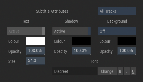

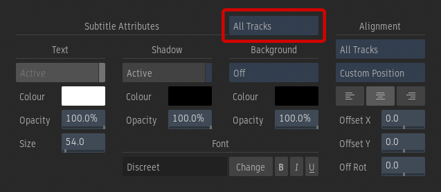

To ensure the uniformity of subtitles on a Subtitle track, use the Attributes Scoping option. With it, you can easily affect a range of Subtitle FX with your changes to the Subtitle Attributes.
  • All Tracks: Modifications are applied to all Subtitle Timeline FX present in the current version of a sequence. This is the default value.
  • Current Track: Modifications are applied to all Subtitle Timeline FX present on the same track.
  • Selected Segments: Modifications are applied to all selected Subtitle Timeline FX. The selection and modifications must be made in the Effects environment.
  • All Layers: Modifications are applied to all layers in the current Subtitle Timeline FX.
  • Current Layer: Modifications are applied to the current layer in the current Subtitle Timeline FX.

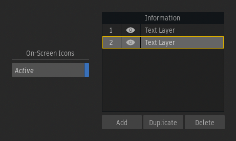

Subtitles list
Lists the subtitle layers. The eye icon mutes a layer. Click a layer to display its Layer Specific options.
Subtitle Attributes
Attributes Scope option
Set the scope of the changes to the subtitle attributes. From affecting only the current layer to all the subtitle tracks.
The Subtitle Timeline Effect offers more option than the Batch node which only offers the possiblity to apply the changes to only one or all layers in the same node.
Select: To apply the changes to:
Selected Layer The selected layer only.
All Layers To all layers.
Selected Segments To all layers in the selected timeline segments.
Current Track To all segments on the current timeline track.
All Tracks To all segments in the current sequence.
Text colour
Set the current subtitle colour. Click to open the colour picker.
Text Opacity field
Sets the opacity of the subtitle.
Text Size field
Sets the font size of the subtitle.
Tracking field
Sets the amount of spacing between all characters in a layer. Positive values increase the spacing. Negative values decrease the spacing.
Note: The Tracking parameter is new to 2026.1 Update
Enable Shadow
Enable to add a drop shadow to the subtitle.
Shadow colour
Set the current shadow colour. Click to open the colour picker.
Shadow Opacity field
Sets the opacity of the drop shadow.
Background Colour option
This adds a rectangular background to the subtitle.
Select: To:
Off Hide the background
Entire Layer Frame the text with a box as wide as the longest line.
Text Only Frame the background tightly around the text.
Background colour
Set the current background colour. Click to open the colour picker.
Background Opacity field
Sets the opacity of the background.
Font field
The font currently in use.
If the chosen font lacks any characters required to process the content of the imported file, you can set a secondary font to display those characters.
If the chosen font lacks any characters required to process the content of the imported file, you can set a secondary font to display those characters. You can configure the secondary font selection in the Preferences panel.
Display Smart Quotes
Quotations marks can be displayed as single or double marks. When the Display Smart Quotes setting is enabled, quotes are rendered in their "curly" version if the font supports the format. The curly version is also shown in the Text Preview of the Load Font window. Regardless of the status of the setting, the quotes remain displayed as single quotes in the Subtitles editor's text field and in an exported SRT file.
The setting can be set in the Preferences panel.
Change Font
Open the font browser to load a font.
Note: As of the 2026.1 Update, Change Font opens the Select Font widget.
Bold
Bold the selected text.
Italic
Italicize the selected text.
Underline
Underline the selected text.

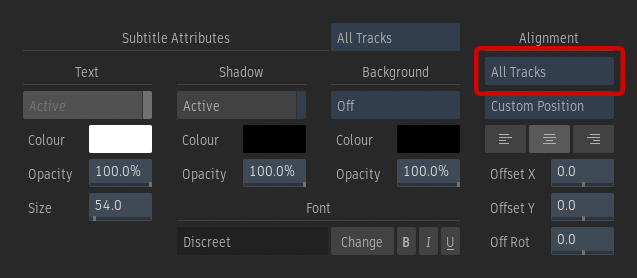

Alignment
Layer Selection option
Set the scope of the changes to the subtitle alignment. From affecting only the current layer to all the subtitle tracks.
Alignment Selection option
Select how the subtitle is positioned: custom coordinates, or relative to Safe Action or Title margins.
Text Alignment option
Set the text justification relative to its layer's axis.
