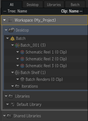

Tab Navigation
The top of the Media panel displays a number of tabs. Click a tab to focus on a specific area of interest in the Media Panel.
All
Displays all areas of the Media panel: Desktop, Libraries, and Batch.
Desktop
Displays only the content of the Desktop.
Note: While Flame Assist does not have an explicit Reels view on the Desktop, it nonetheless maintains the Reels structure from material imported from Flame, in the Media Panel.
Libraries
Displays only the Libraries and Shared Libraries folders.
Batch
Displays only the currently-active Batch Group, along with its Schematic Reels, Shelves, and Iterations.
Conform
Only available while working in the Conform environement, replacing the Batch tab described above. Displays only media available for the conform, filtered by match criteria.
BFX
Only available while working in Batch FX, replacing the Batch tab described above. Displays only media used in the current Batch FX.

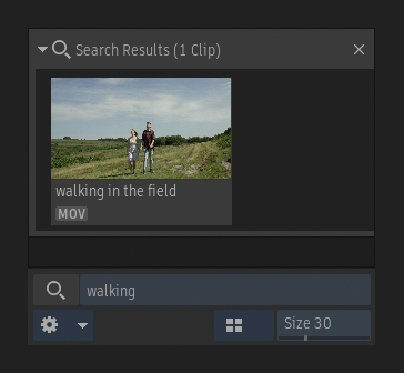

Searching in the Media Panel
To perform a simple name search, enter text in the field at the bottom of the Media Panel and press Enter. A Name Search Results area appears near the bottom of the Media Panel to display the search results.
If you need a more advanced Media Panel search, click the magnifying glass icon to open the Search in Media Panel window.
