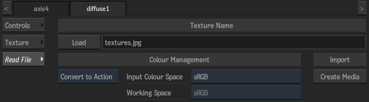

Working With Textures in Map Nodes
You create maps in Action (such as Diffuse and Reflection maps) based on media from the Media list. In some cases, such as with Substance Textures, the media is automatically applied to map nodes. To specify different media as the texture source, select the media in the Media menu, then click Apply. If the media you want to use resides elsewhere on your file system, you can use the Read File tab of the map menu to load the texture, and then decide if you want the texture to be managed by Action, or not.
Load button
Click to open a browser to select an external texture for the map.
Name field
This locked field displays the name of an externally loaded texture.
Create Media button
Click to convert the external texture into an Action-managed texture. The Texture Name is removed from this menu, and the texture appears in the Action Media list instead, assigned as a proper layer to the texture in the schematic.
