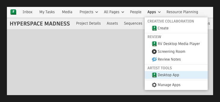

Flow Production Tracking Desktop is a standalone application that you can download and install from the Apps menu of your Flow Production Tracking website.
Flow Production Tracking Desktop is a full fledged application in which you can see all of your projects, perform project management, launch projects with a selected application and which allows for customization of the various Flow Production Tracking components to make the application more compatible with your facility and production pipeline. Flow Production Tracking Desktop enables the Review & Approval workflow, as well as the Shot Export workflow.
