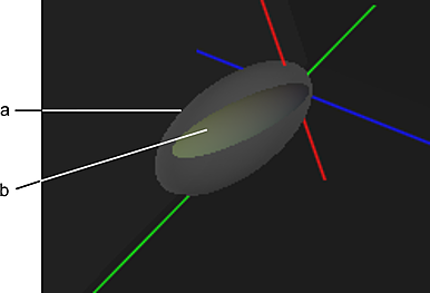

A softness ellipsoid appears in the RGB viewer. Notice the tolerance ellipsoid in the softness ellipsoid.
(a) Softness ellipsoid (b) Tolerance ellipsoid
All colours in the softness ellipsoid (except those inside the tolerance ellipsoid) will be grey on the matte. In the softness ellipsoid, the closer a point is to the tolerance ellipsoid, the darker the grey will be. For example, the mid-point between the edge of the tolerance ellipsoid and the edge of the softness ellipsoid is always the same mid-grey.
Notice how the softness ellipsoid increases in size as you sample the edges.

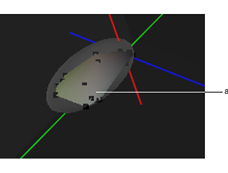

Note: The softness is rendered interactively on the matte - you see the results immediately. For information on rendering the softness only after releasing the cursor, see Regen.Like the tolerance ellipsoid, the softness ellipsoid has a convex hull. To see it clearly, set the Tolerance Display and Tolerance ConvexHull display to None, and set the Softness ConvexHull display to Vert&Surf.
(a) Softness convex hull
