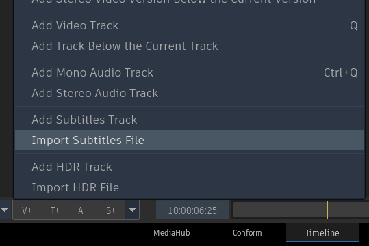

  • Add a Subtitles track with Timeline context menu New Tracks and Versions Add Subtitles Track or click Add Subtitles Tracks.

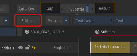

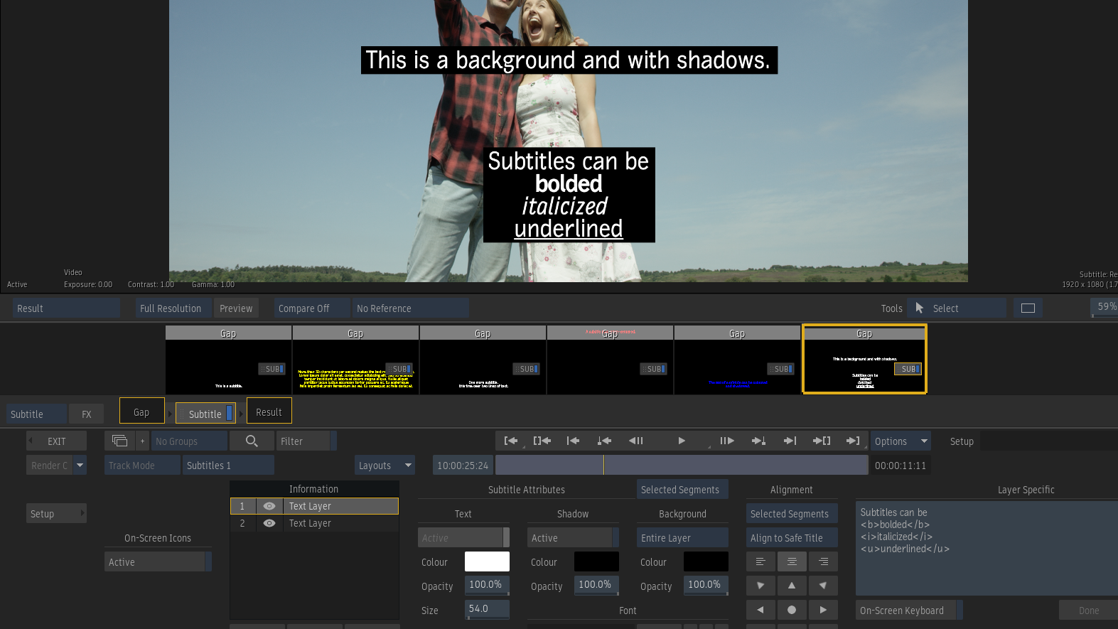

To add a subtitle:

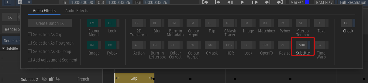

  1. Select a Gap on the Subtitle track.
    Right-click your video track and select Copy Transitions to Track Subtitle Track to create on the Subtitle track the gaps for your subtitles.
  2. Insert a Subtitle Timeline FX.
  3. Click Editor to open the Effects tab.
  4. In the Effects tab, use the Subtitles Timeline FX editor to add your subtitles to text layers.
    Enter the subtitle and format the text using the Text, Shadow, Background, and Alignment options.
To edit a Subtitle track:

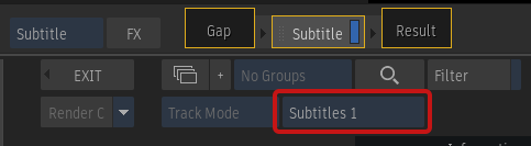

  • In the Effects tab, select Subtitle FX Mode box Subtitle to switch to the Subtitle tracks.
  • Select the Subtitle track to edit from the Track and Version Selection box.
  • Select a segment to display its Subtitle Timeline FX.
    Note: You can also double-click a Subtitle FX in Timeline to open it in Effects.
  • Edit the subtitle in the Subtitles Timeline FX editor.

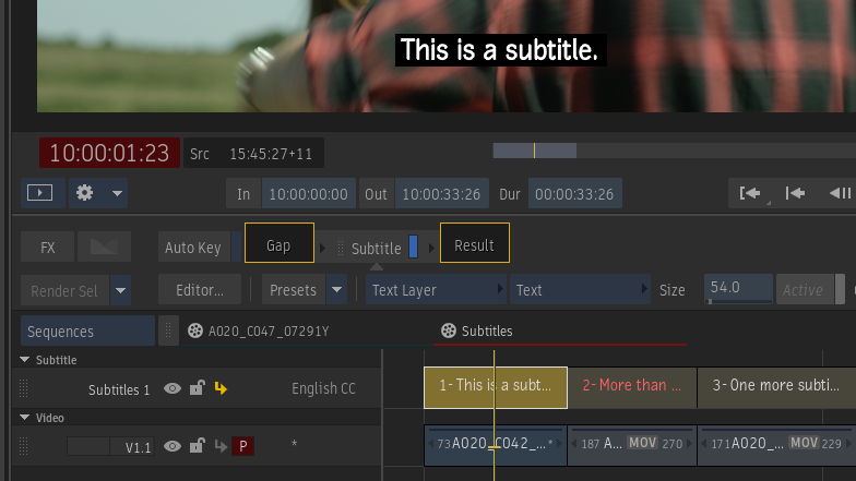

About the Subtitle Track
The Subtitle track holds the subtitles of a clip. Each subtitle is a Subtitle Timeline FX on a Gap in the Subtitle track.
The Subtitle track behaves like a Video track, with the following differences:
  • You cannot patch a Subtitle track.
  • You can only see the output of one Subtitle track, all other Subtitle tracks are muted. Use to hide and show a Subtitle track.
  • The Rippling function is enabled by default.

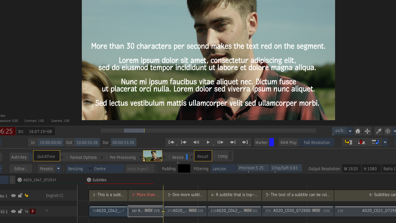

Note: If a subtitle layer contains more than 30 characters per second, the event appears in red on the Timeline. Adjust the Warning Threshold in Preferences Tools / TL FX Subtitles.

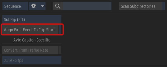

Importing Subtitles
When working with subtitles, you are often provided with a file that contains the subtitles for the sequence you are working on. This subtitles file contains the subtitle text and the timings for the text in the form of timecodes.
You can import directly into your sequence subtitles from either SubRip Subtitle (SRT) files or Avid subtitle text files.

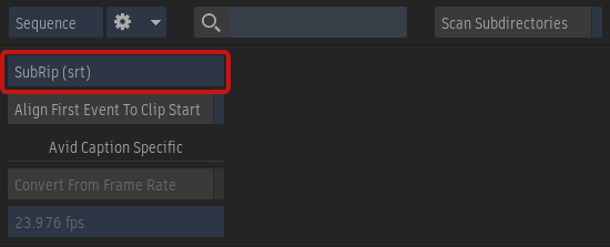

To import a subtitle file:
  1. From the Create Track menu, click Import Subtitles File.
  2. In the Import Subtitles window, filter for SubRip (SRT) or Avid Caption (txt) files.
    You can import multiple subtitle files at the same time, as long as they are of the same type (SRT or Avid).
  3. In the file browser, navigate to your subtitle file, and select it.
  4. Click Load.
    Each subtitle is laid out on the Subtitles track as a Subtitle Timeline FX on a Gap.

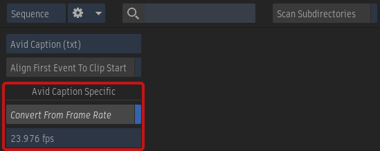

Align First Event to Clip Start: This option ignores the time information from the subtitle files.
An Avid Caption file does not specify its frame rate. For the best results, when importing an Avid Caption file, enable Convert From Frame Rate and select the frame rate of the captions.

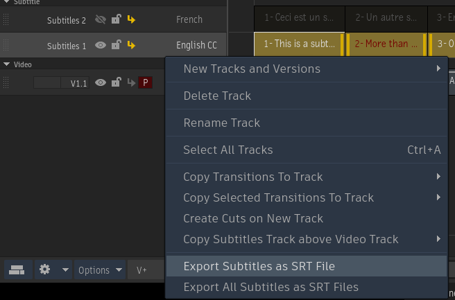

Exporting Subtitles as a Standalone SRT File
When you export a subtitle track, it's always in the SRT format. While you can import Avid Caption files, you cannot export subtitles as Avid Captions.
To export a subtitle track:
  1. Right-click the Timeline canvas and select Export Subtitles as SRT File.
  2. From the Subtitle Tracks drop-down, select the track to export.

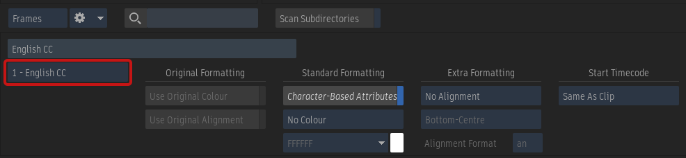

  3. Set the Standard Formatting, Extra Formatting, and Start Timecode options as required.
    Original Formatting options are only available when exporting a Subtitle track you created by importing a Subtitle file.
  4. Click Load.
You can also export all Subtitle tracks with Export All Subtitles as SRT Files. In this case, each Subtitle track is exported in its own SRT file, and you don't have to select the track to export.

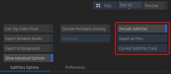

Export with Subtitles Burned In the Media
The Include Subtitles button can be enabled in the Media Export window to either burn the subtitles inside the exported clip or export them as separate files.
Burning-in the subtitles is the only export method that supports all the settings of the Subtitle Timeline FX, including layer opacity, shadow, and background.
The Hardware and Software Anti-Aliasing values set in a Subtitle setup are applied on export.
To burn the Subtitle track in the media:
  1. Right-click the sequence and select Export...
  2. Select an export preset or set up your export options.
  3. Enable Include Subtitles.
  4. Set Subtitle Export Mode to Burn in Image.
  5. Select the Subtitle track to output.
    The option Current Subtitle Track selects the track that is currently displayed in Timeline.
  6. Click Export.
  4. Set Subtitle Export Mode to Export as Files.
  5. Select the Subtitle track to export.
    You choose to export all Subtitle tracks of a sequence. In this case, the export produces one SRT file for each Subtitle track.

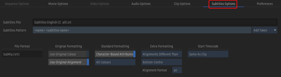

  6. Enable Show Advanced Options.
  7. Open the Subtitles Options tab.
  8. Set the Standard Formatting, Extra Formatting, and Start Timecode options, as required.
  9. Edit the Subtitles Pattern field to create the SRT file name. Use the Token box to create dynamic names.
