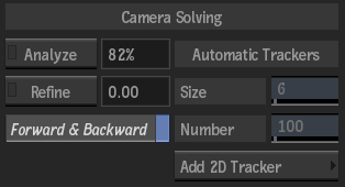

Use the settings in the Camera Solving section to perform an automatic 3D track.
Camera Tracking
Displays the Camera Tracking menu, where you can track based on the settings of the camera.
Not shown in the screenshot above.
Analyze
Click to analyze the image (when complete, the Analyze button changes to Update).
Update
Click to delete all previous 3D points, and start tracking based on new information.
Analyze Progress field
Displays the progress of analyzing or updating.
Refine
Click to use the current results of the track analysis as a starting point, and refine from this point. Click Refine again to stop the process.
Pixel Error Value field
Displays a representation of the distance of 2D tracks from repositioned 3D points.
Forward & Backward
Enable to track the image sequence backward after the forward tracking has completed.
Size field
Displays the size of the trackers.
Number field
Displays the number of 2D tracks created by the analysis.
Add 2D Tracker
Click to enter the Stabilizer to add manual trackers.
Reset Tracker
Resets all tracker data in the Analyzer menu.

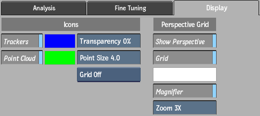

Tracker Display Settings
The settings help you view your trackers in the image window.
Tracker Display
Enable to display 2D tracks in the image.
Tracker Display colour
Displays the colour of the trackers.
Point Cloud Display
Enable to display 3D tracker points in your image.
Points Display colour
Displays the colour of the points.
Transparency field
Displays the transparency level of the trackers and points in the image.
Point Size field
Displays the size of the 3D points in the image.
Grid option
Select the type of grid to display in the scene. Use to position objects in the scene more accurately.
Select: To:
Grid Off Disable the grid.
Grid XY Use a grid constructed on the X and Y planes.
Grid XZ Use a grid constructed on the X and Z planes. The XZ grid is visible only when the camera is moved from its default position.
Grid YZ Use a grid constructed on the Y and Z planes. The YZ grid is visible only when the camera is moved from its default position.
Note: The Action grid is independent from the global grid in the Grids and Guides menu.
You can change the display of the perspective grid with the following settings (available when Perspective Based is selected as the Focal Length option in the Analysis menu):
Show Perspective
Enable to display the grid corners in the Analyzer view.
Grid
Enable to display the perspective grid in the Analyzer view.
Grid Colour
Displays the colour of the grid lines. Click to change the colour.
Magnifier
Enable to display the magnifier while dragging a corner of the perspective grid rectangle.
Zoom field
Displays the zoom factor of the magnifier.
