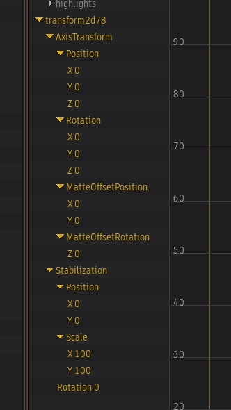

Improved Filters
The Name filtering criteria now also considers folder names. If a folder's name matches the filter, all its channels are selected in the channels list.
For example, a Name filter *tion matches the following folder names in a 2D Transform node:
Under AxisTranform:
  • Position
  • Rotation
  • MatteOffsetPosition
  • MatteOffsetRotation
Under Stabilization:
  • Position
  • Scale
  • Rotation
Scale is selected even if doesn't match the *tion pattern. It is selected because the parent folder, Stabilization, does match the pattern.

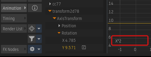

Expressions Improvements
  • You can now open the Expression field with a double-click on the icon.
  • The current expression no longer overwrites the frame count at the bottom of the canvas.
