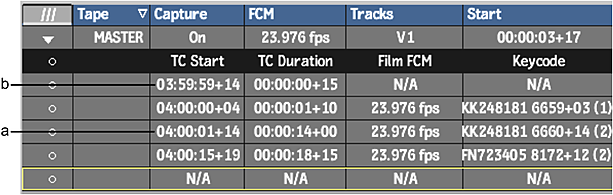

To slip the keycode for a given tape:
  1. In the Import EDL menu, from the Display group, enable View Tape List.
  2. If necessary, click the triangle on the left of the tape entry to expand its contents.
    Sequences of timecode on the tape are associated to keycode values. If no keycode is available from the telecine log(s) you loaded, N/A (not available) appears for the sequence.
    (a) Timecode start and duration defines sequence, with corresponding keycode (b) Timecode without corresponding keycode
  3. To edit the keycode for a sequence, do one of the following:
    • Drag the keycode entry you want to modify to the right to increase the value or to the left to decrease the value.
    • Click the keycode entry you want to modify to get the keycode calculator, and then enter a new keycode.
      The keycode values associated to the timecode sequence (defined by the values in TC Start and TC Duration fields) are altered.
      If you change the frame rate in the keycode calculator, it is reflected in the Film FCM field.
