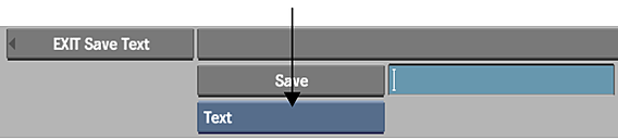

  1. In a Text tool, create a text setup.
  2. Click Save.
  3. In the Save menu, select Selected Layers from the Save box.
  4. Choose the directory into which you want to save the file.
  5. Type a name for the file and press Enter or click the Save button.
    The file is saved and you return to the Text tool.
