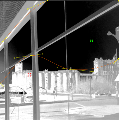

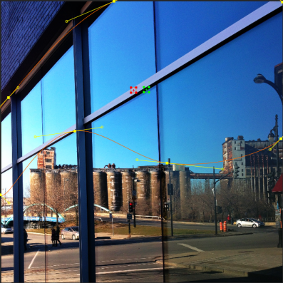

  4. Identify which frame you would like to create your first key shape on and click Add.
    Doing so creates two colour picker boxes in the centre of the GMask shape; one to identify the Background colour (green box) that you would like to key out, and the other the Foreground colour that you would like to preserve (red box).
  5. Resize and position the colour picker boxes, as needed.
    Tip: If colour picker boxes are overlapping, press Q to toggle between selections.
  6. If needed, use Add Background and Add Foreground to add and position more colour pickers at the same frame.
  7. Use other settings in the Tracer menu, such as to add softness, invert the colour pickers, apply to the GMask gradient only, or add post-processing refinements.
    Tip: Click F8 again to see the result of the keying operation in context.
    Click F4 to see the GMask only.
  8. There may be colour or lighting variations in the clip. If a good key cannot be performed for the whole duration of the clip, you can move to another frame where you would like to create a new key shape, and click Add once more, then follow from Step 5. Tracer settings are interpolated between keyframes.
