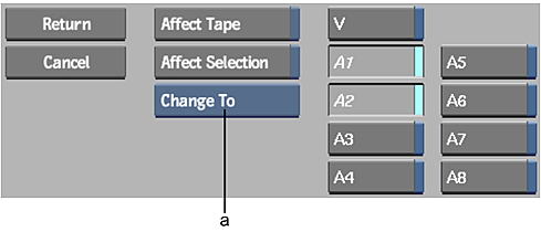

  1. In the EDL work area, select the Track entries in the event that you want to edit from the EDL.
    The Track menu appears.
    (a) Track Tools box
  2. Enable the tracks that you want to edit.
  3. Enable or disable the Affect Tape and Affect Selection buttons.
  4. From the Track Tools box, select the mode that you want to use.
    Select: To:
    Change To Replace tracks in the event with tracks you specified in the Track menu.
    Add Add the tracks you specified in the Track menu to the tracks in the event.
    Filter Keep only the tracks you specified in the Track menu. For example, if an event is “V12” and you specify “V1,” audio track 2 is filtered out, and the resulting event has “V1.”
    Flip Reverse the status of tracks you specified in the Track menu. For example, if an event is “V23” and you specify “V34,” the resulting event has “V24.”
  5. Click Return to confirm the change or Cancel to exit back to the EDL module without making any modifications.
