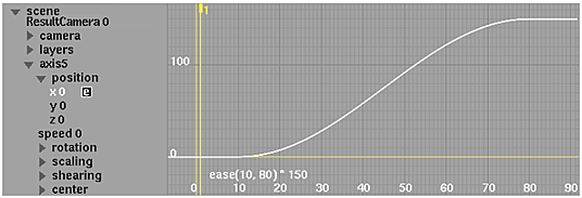

  • ease(10, 80) * 150 yields the following curve:

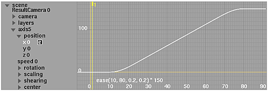

  • ease(10, 80, 0.2, 0.2) * 150 yields the following curve:

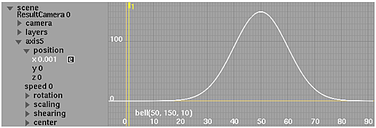

  • bell(50, 150, 10) yields the following curve:

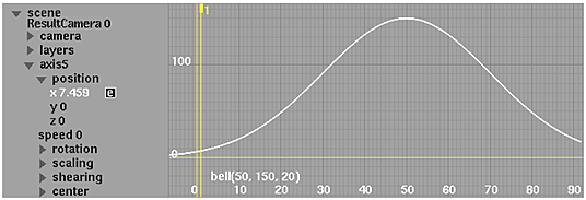

  • bell(50, 150, 20) yields the following curve:
