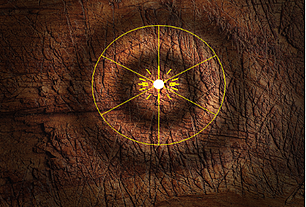

For example, a curve such as this.
Results in a lighting ripple-like effect.
