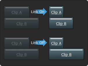

Select Backward / Forward Select one of four options: Single Track Forward, Single Track Backward, All Tracks Forward, or All Tracks Backward. When selected, a single click on a Timeline segment selects one or all segments before/after the segment. The state of the Link button affects the selection.
