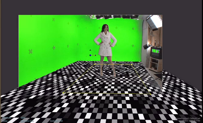

Load front and back clips in Action.
Double-click the image node in the schematic to display the Surface menu.
Select Perspective from the Surface Type box.

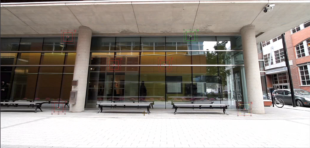

Click the Vertices tab to display the Stabilizer button and tracking options, to track the Vertices relative to the background (track the perspective).
Select Perspective from the Tracking Mode box.
This tracking mode allows you to add as many trackers as you want and position them in the same plane as your surface, to cover as much of the perspective transformation as possible.

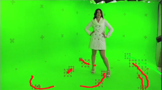

Note: The Position, Rotation and Scale settings of the vertices or UV points in Z are reset when entering the Stabilizer.Position and add trackers on the background clip, as needed.
Gang the trackers.
Enable Auto Update Reference.
Click Analyze to generate the tracking data.
The motion is tracked

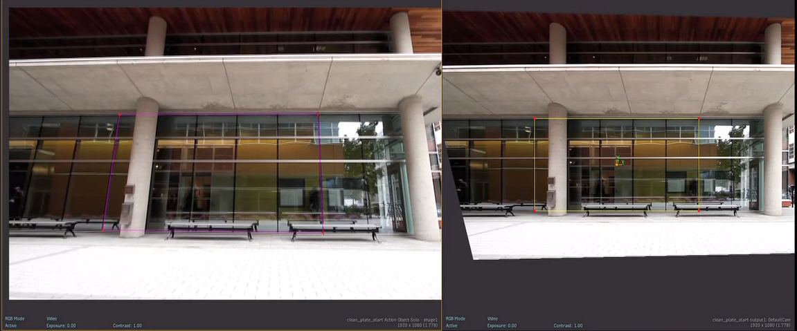

To correct and stabilize the perspective:
Access the Surface menu.

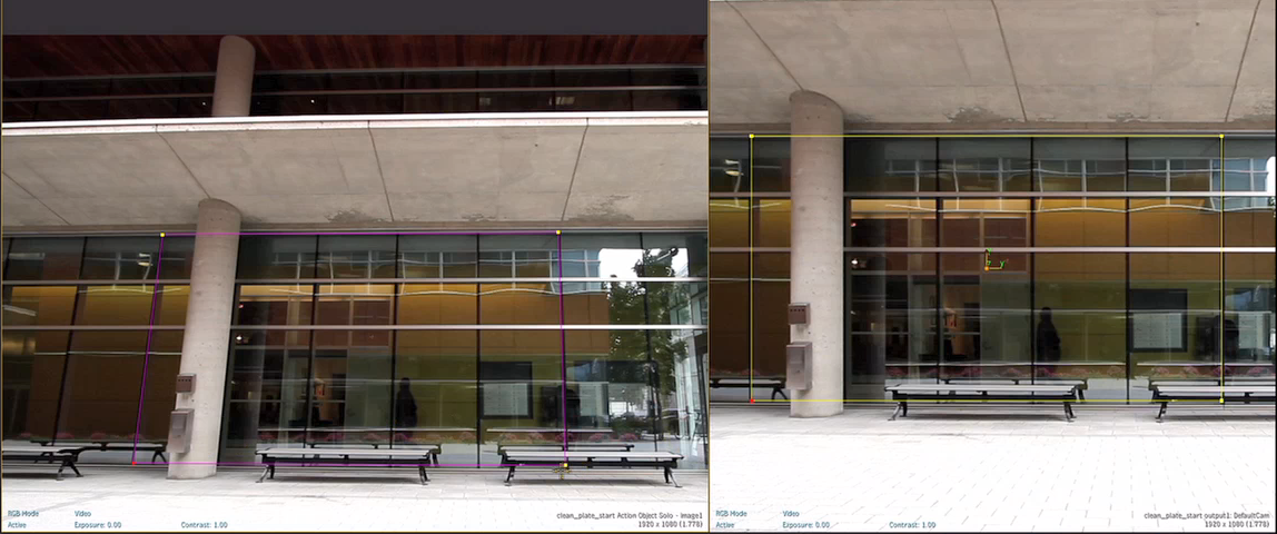

Position the UV points to isolate and correct the perspective on the desired portion of the shot.
Select the four UV points.
Click the UV Points tab to display the Stabilizer button and the tracking options.

Note: The Position, Rotation and Scale settings of the vertices or UV points in Z are reset when entering the Stabilizer.Add trackers and position them as needed.
Gang the trackers.
The motion is tracked.
Exit the Stabilizer.
The perspective is corrected and stabilized.
