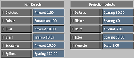

Film Settings
Use the Film Damage effects to apply a large variety of film degradation effects to a clip.
When you select Film from the Damage type box, the Film Damage Effects are displayed, along with the most useful adjustment box to the right of each.

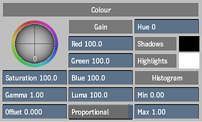

Colour Settings
Colour button
Use this effect to simulate colour fading and variation in old film.
Colour Gain trackball
Drag to adjust the colour gain. This is an alternate control combining the Red Gain, Green Gain, Blue Gain, and Luma fields.
Colour Saturation field
Displays the level of colour purity in the image.
Colour Gamma field
Displays the amount of gamma correction applied to the image.
Colour Offset field
Displays the amount by which all the colour parameters are modified.
Red Gain field
Displays the amount of gain applied to the red channel.
Green Gain field
Displays the amount of gain applied to the green channel.
Blue Gain field
Displays the amount of gain applied to the blue channel.
Luma field
Displays the amount of gain applied to the luminance channel.
Proportional button
Enable to synchronize changes in red, green, blue, and luma channels.
Hue field
Displays the colour range.
Shadows colour pot
Displays the tint applied to shadows in the image.
Highlights colour pot
Displays the tint applied to highlights in the image.
Minimum Colour Value field
Displays the luminance value in the image shadows.
Maximum Colour Value field
Displays the luminance value in the image highlights.

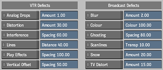

Analog Drop Settings
Analog Drops button
Use this effect to simulate analog drops causing noise or shash when playing back old tapes on VTRs. .
Drop Type box
Select an option for the type of noise.
Drop Amount field
Displays the amount of shash applied to the image.
Drop Amount Variation field
Displays the percentage of variation in the amount of shash applied to the image.
Drop Transparency field
Displays the percentage of transparency applied to the shash.
Drop Transparency Variation field
Displays the percentage of variation in the transparency applied to the shash.
Drop Type Variation field
Displays the percentage of variation applied to the drop type.
Distortion Settings
Distortion button
Use this effect to simulate edge distortion when playing back old tapes on VTRs.
Edge Distortion Amount field
Displays the amount of edge distortion applied to the image.
Edge Distortion Amount Variation field
Displays the percentage of variation in the amount of edge distortion.
Edge Distortion Transparency field
Displays the percentage of transparency applied to the edge distortion effect.
Edge Distortion Transparency Variation field
Displays the percentage of variation in transparency applied to the edge distortion effect.
Edge Distortion Coverage field
Displays the percentage of vertical spread for the edge distortion effect.
Edge Distortion Scale field
Displays the size scaling applied to the edge distortion effect.
Edge Distortion Vertical Offset field
Displays the vertical offset applied to the edge distortion effect.
Edge Distortion Speed field
Displays the speed at which the edge distortion effect moves across the image.
Edge Distortion Speed Variation field
Displays the percentage of variation in the speed at which the edge distortion effect moves.
Edge Distortion Speed Variation Period field
Displays the time period in frames within which the speed variation occurs.
Interference Settings
Interference button
Use this effect to simulate electromagnetic Interference when playing back old tapes on VTRs.
Interference Amount field
Displays the amount of electromagnetic interference applied to the image.
Interference Transparency field
Displays the percentage of variation in the amount of electromagnetic interference applied to the image.
Interference Coverage field
Displays the percentage of vertical spread applied to the electromagnetic interference effect.
Interference Scale field
Displays the scaling applied to the electromagnetic interference effect.
Interference Vertical Offset field
Displays the vertical offset applied to the electromagnetic interference effect.
Interference Spacing field
Displays the spacing in frames between electromagnetic interference effects.
Interference Spacing Variation field
Displays the percentage of variation in spacing between electromagnetic interference effects.
Interference Duration field
Displays the duration in frames of the electromagnetic interference effects.
Interference Duration Variation field
Displays the percentage of variation in duration for the electromagnetic interference effects.
Lines Settings
Lines button
Use this effect to simulate ones caused by noise artifacts when playing back old tapes on VTRs.
Lines Distance Amount field
Displays the amount of distance between the noise artifact lines applied to the image.
Lines Jittering Amount Variation field
Displays the percentage of variation in the jitter applied to the lines.
Lines Transparency field
Displays the percentage of transparency applied to the noise artifact lines.
Lines Transparency Variation field
Displays the percentage of variation in the transparency of the lines.
Lines Angle field
Displays the angle of the noise artifact lines.
Lines Speed field
Displays the speed at which the noise artifact lines move around.
Lines Speed Variation field
Displays the percentage of variation in the speed of the noise artifact lines.
Lines Speed Variation Period field
Displays the time period in frames within which the noise artifact lines occur.
Play Effects Settings
Play Effects button
Use this effect to simulate play effects caused by misaligned or dirty tape heads when playing back old tapes on VTRs.
Play Effects Amount field
Displays the amount of play effects added to the image.
Play Effects Speed field
Displays the speed at which the play effects occur.
Play Effects Freeze field
Displays the number of repeat frames added to create a jerky play effect.
Play Effects Spacing field
Displays the spacing in frames between play effect errors.
Play Effects Spacing Variation field
Displays the percentage of variation in spacing between play effect errors.
Play Effects Duration field
Displays the duration in frames of the play effect errors.
Play Effects Duration Variation field
Displays the percentage of variation in duration of the play effects.
Vertical Offset Settings
Vertical Offset button
Use this offset to simulate vertical rolls when playing back old tapes on VTRs.
Vertical Offset Roll Amount field
Displays the amount of vertical roll applied to the image.
Vertical Offset Roll Amount Variation field
Displays the percentage of variation in the amount of the vertical roll.
Vertical Offset Jitter field
Displays the amount of jitter applied to the vertical roll.
Vertical Offset Border Width field
Displays the width of the vertical roll border.
Vertical Offset Border Artifacts field
Displays the amount of artifacts within the vertical roll border.
Vertical Offset Spacing field
Displays the spacing in frames between vertical roll errors.
Vertical Offset Spacing Variation field
Displays the percentage of variation in spacing between vertical roll errors.
Vertical Offset Duration field
Displays the duration in frames of the vertical roll errors.
Vertical Offset Duration Variation field
Displays the percentage of variation in duration for the vertical roll errors.
Blur Settings
Blur button
Use this effect to simulate blur from poor signal reception.
Blur Amount field
Displays the amount of blurring added to the image.
Blur Amount Variation field
Displays the percentage of variation in the amount of the blur effect.
Colour Settings
Colour button
Use this effect to simulate analog colour degradation, shift and variations from poor signal reception.
Analog Colour Degrade Amount field
Displays the amount of colour degradation applied to the image.
Analog Colour Degrade Amount Variation field
Displays the percentage of variation in the amount of the colour degradation.
Analog Colour Contrast Transparency field
Displays the amount of contrast applied to the image.
Analog Colour Brightness Transparency Variation field
Displays the amount of brightness applied to the image.
Analog Colour Saturation field
Displays the amount of colour saturation applied to the image.
Analog Colour Shadows colour pot
Analog Colour Highlights colour pot
Analog Colour Red Channel Gain field
Analog Colour Green Channel Gain field
Analog Colour Blue Channel Gain field
Analog Colour Red Channel X Shift field
Displays the amount of horizontal offset applied to the red channel.
Analog Colour Green Channel X Shift field
Displays the amount of horizontal offset applied to the green channel.
Analog Colour Blue Channel X Shift field
Displays the amount of horizontal offset applied to the blue channel.
Analog Colour Red Channel Y Shift field
Displays the amount of vertical offset applied to the red channel.
Analog Colour Green Channel Y Shift field
Displays the amount of vertical offset applied to the green channel.
Analog Colour Blue Channel Y Shift field
Displays the amount of vertical offset applied to the blue channel.
Ghosting Settings
Ghosting button
Enable to simulate ghosting from poor signal reception.
Ghosting Amount field
Displays the number of repeated ghost images applied to the original image.
Ghosting Amount Variation field
Displays the percentage of variation in the number of ghost images.
Ghosting Transparency field
Displays the percentage of the transparency applied to the ghosted images.
Ghosting Transparency Variation field
Displays the percentage of variation in the transparency of the ghosted images.
Ghosting Distortion field
Displays the amount of distortion applied to the ghosted images.
Ghosting Scale field
Displays the amount of scaling applied to the ghosted images.
Ghosting Angle field
Displays the angle applied to the ghosted images.
Ghosting Colour Degradation field
Displays the amount of colour degradation applied to the ghosted images.
Ghosting Spacing field
Displays the spacing in frames between ghosting errors.
Ghosting Spacing Variation field
Displays the percentage of variation in spacing between ghosting errors.
Ghosting Duration field
Displays the duration in frames of the ghosting errors.
Ghosting Duration Variaton field
Displays the percentage of variation in the duration of ghosting errors.
Scanlines Settings
Scanlines button
Use this effect to simulate scanlines from poor signal reception.
Scanlines Scale field
Displays the size of the scanlines applied to the image.
Scanlines Variation field
Displays the percentage of variation in the size of the scanlines.
Scanlines Variation Speed field
Displays the speed at which the scanline variation occurs.
Scanlines Transparency field
Displays the percentage of transparency applied to the scanlines.
Scanlines Vertical Offset field
Displays the vertical offset for the scanline effect.
Scanlines Softness field
Displays the amount of softness applied to the scanlines.
Scanlines Angle field
Displays the angle at which the scanlines occur.
Snow Settings
Snow button
Enable to simulate snow from poor signal reception.
Snow Amount field
Displays the amount of snow applied to the image.
Snow Amount Variation field
Displays the percentage of variation in the amount of snow applied to the image.
Snow Transparency field
Displays the percentage of transparency or softness, applied to the snow.
Snow Transparency Variation field
Displays the percentage of variation in the transparency or softness, applied to the snow.
Snow Sparseness field
Displays the density of the snow.
Snow Width field
Displays the width in pixels of the snow particles.
Snow Height field
Displays the height in pixels of the snow particles.
Snow Proportional button
Enable to effect the width and height proportionally.
TV Distort Settings
TV Distort button
Use this effect to simulate TV lens distortion from a poor video camera.
TV Distort Amount field
Displays the amount of TV lens distortion applied to the image.
TV Distort Amount Variation field
Displays the percentage of variation in the amount of TV lens distortion applied to the image.
TV Distort Radius field
Displays the size of the image to which the TV lens distortion is applied. A value of 1 includes the entire image.
TV Distort Ratio field
Displays the ratio of height to width that is affected by the TV lens distortion effect.
