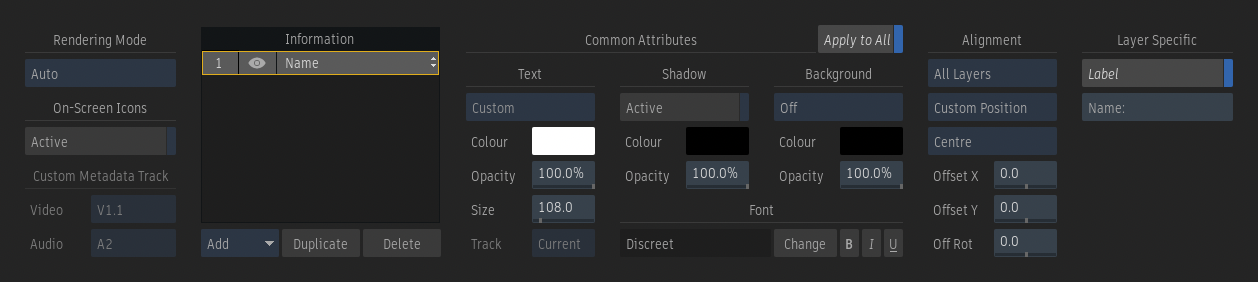

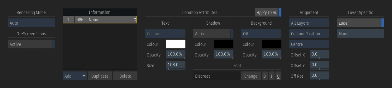

Settings for the Burn-In Metadata tool differ between Batch and the Timeline. The following documentation presents the controls for the Batch node and for the Timeline FX, as presented in the Effects environment. It is also possible to modify the Burn-In Metadata controls from the Timeline ribbon, on the Timeline tab.
The Burn-In Metadata settings in Batch
The Burn-In Metadata settings in the Effects environment

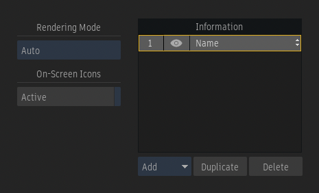

Rendering Mode optiom
Select Automatic to render using the scan format of the input, or render in Progressive or Interlaced mode.
Note: The Rendering Mode parameter is now located in the Node Prefs submenu.
On-Screen Widgets
Enable to display layer widgets in the viewport. Use the widgets to move the layer in X and Y, or rotate in Z. Alignment options allow you to affect only the selected layer or every layers.
Note: The On-Screen Icons option has been renamed On-Screen Widgets and is now located in the Viewing toolbar, to the left of the Tools drop-down.
Information list
Lists all of the added information layers. Use the buttons below to populate the list with the information layers you want. Use the eye icon to mute a layer. Click a layer to display its Layer Specific options.

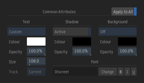

Common Attributes
Apply to All
Enable to have the Common Attributes applied to every layer in the Displayed Information list. Disable to apply the attributes only to the currently selected layer.
Text Colour option
Select the source for the colour of the text: Segment to use the colour of the segment, Timeline/Clip to use the colour of the clip, or Custom to use the Text colour pot.
Text Custom Colour
Sets the custom colour of the burned-in text.
Text Opacity field
Sets the opacity of the burned-in text.
Text Size field
Sets the font size of the burned-in text.
Tracking field
Sets the amount of spacing between all characters in a layer. Positive values increase the spacing. Negative values decrease the spacing.
Note: The Tracking parameter is new to 2026.1 Update
