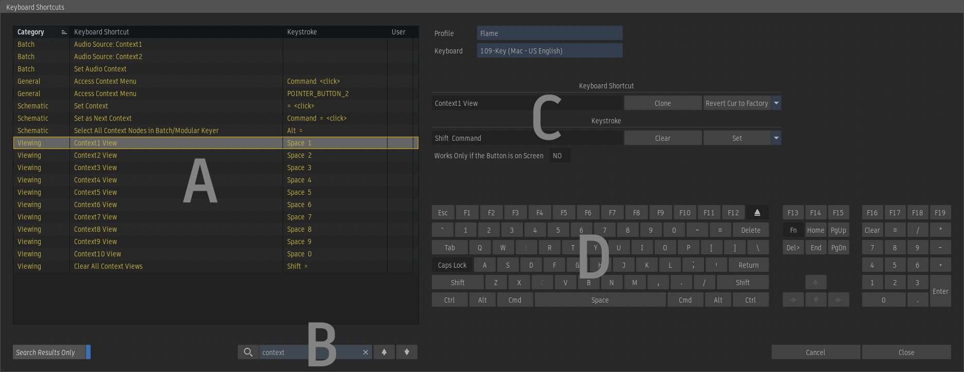

From the main menu at the bottom right of the application, select Keyboard Shortcuts... or use the keyboard shortcut Ctrl+Alt+F8.
(A)Keyboard Shortcuts Catalogue (B)Search Field (C)Keyboard Shortcut Manager (D)Active Keyboard**

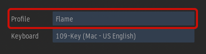

Selecting Your Shortcuts Profile
In the Keyboard Shortcuts Editor, you have the option to choose from one of the four pre-set keyboard shortcuts profiles provided by the application. Each profile assigns different keystrokes to various shortcuts. The available options are:
  • Flame
  • Smoke Classic
  • Smoke (FCP 7)
  • Lustre
Note: Changes made to the keyboard shortcuts catalogue are only applied to the current profile.

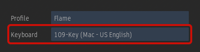

Selecting Your Keyboard Type
In the Keyboard Shortcuts Editor, you also have the option to select the type of keyboard you are using. This feature allows you to use the additional keys available on some keyboards.
When you select your keyboard type, the on-screen keyboard adjusts to reflect your choice, and the entries in the Keyboard Shortcuts catalogue update accordingly. If a keyboard shortcut is assigned to a key that isn't available on the selected keyboard, the Keyboard Shortcuts catalogue displays that entry in black.
