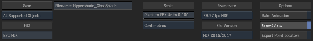

FBX Export Settings
FBX Mode option
Select whether to export all supported FBX objects, or only the selected FBX objects.
File Extension field
Displays the default extension for the file type selected (in this case, FBX).
Filename field
Displays the file name for the exported FBX model.
Pixels to FBX Units field
Displays the scaling factor to apply to the exported FBX file to be used in the 3D application. Use the Units option to select the unit of measurement.
Units option
Select a unit of measurement to apply to the exported FBX file.
Framerate option
Select a framerate for the exported FBX file.
FBX File Version option
Select which FBX version to export the file to.
Bake Animation
Enable to add a keyframe at every frame of the exported FBX camera file.
Export Axes
Enable to export the animated axes present in the Action scene.
Export Point Locators
Enable to export the 3D point locators created by the Analyzer.
