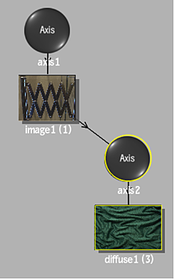

    The diffuse object is added to the schematic with its own parent axis. The new axis is the child of the selected surface or geometry. In Schematic view, the number in brackets next to the name of the Diffuse node indicates the media used for the diffuse.
