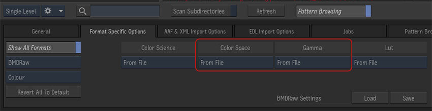

The default Tagged Colour Space is BMD Film/WideGamut Gen5. You specify a different colour space with Format Specific Options BMDRaw Colour where you set the Colour Space and Gamma to define the tagged colour space to use in Flame according to the previous table.

To import .braw clips set to DaVinci Wide Gamut Intermediate:
  1. In MediaHub, openFormat Specific Options BMDRaw Colour.
  2. Set:
    • Colour Space: DaVinci Wide Gamut
    • Gamma Curve: DaVinci Intermediate
Note: Use Timeline FX pipeline > Format Options for imported content.
