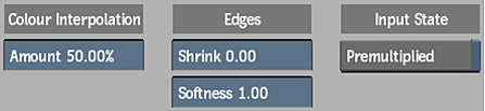

The following settings are available when Interpolate is selected from the Spread Type box.
Interpolation Softness Amount field
Displays the amount of softness applied.
Edges Shrink Amount field
Displays the amount of shrinking applied to the edges.
Edges Shrink Softness field
Displays the softness of the edge.
Interpolation Source Premultiplied button
Enable to verify if the source is already premultiplied, in which case the interpolation effect must treat the image differently for the effect to work properly.

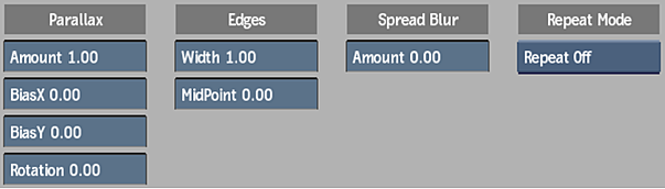

The following settings are available when Parallax is selected from the Spread Type box.
Parallax Amount field
Displays the amount of parallax distortion applied to the clip, in pixels.
Parallax X Bias field
Displays the amount of horizontal offset applied to the parallax distortion effect, in pixels.
Parallax Y Bias field
Displays the amount of vertical offset applied to the parallax distortion effect, in pixels.
Parallax Rotation field
Displays the degree of rotation applied to the pixel distortion.
Edges Width field
Displays the width of the distortion edge, in pixels.
Edges MidPoint field
Displays the offset of the distortion edge from the middle.
Spread Blur Amount field
Displays the amount of blur applied to the clip following the direction of the edge.
Parallax Repeat Mode box

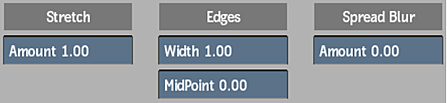

The following settings are available when Stretch is selected from the Spread Type box.
Stretch Amount field
Displays the amount of stretching distortion applied to the clip, in pixels.
Edges Width field

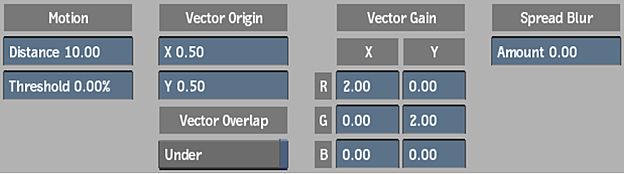

The following settings are available when Vector Warp is selected from the Spread Type box.
Motion Distance field
Displays the amount of distortion to be applied to the image based on a given motion vector. A negative amount inverts the direction of the spread.
Motion Threshold field
Displays the percentage for the cut-off point below which motion data is not applied to the image.
Vector X Origin field
Displays the starting point of any horizontal motion, which can be used to offset values entered for X Gain.
Vector Y Origin field
Displays the starting point of any vertical motion, which can be used to offset values entered for Y Gain.
Vector Overlap button
Enable to invert the effects of the vector warp.
Red X Gain field
Displays the amount of gain used from the red channel to augment the horizontal motion of the distortion effect on the image.
Red Y Gain field
Displays the amount of gain used from the red channel to augment the vertical motion of the distortion effect on the image.
Green X Gain field
Displays the amount of gain used from the green channel to augment the horizontal motion of the distortion effect on the image.
Green Y Gain field
Displays the amount of gain used from the green channel to augment the vertical motion of the distortion effect on the image.
Blue X Gain field
Displays the amount of gain used from the blue channel to augment the horizontal motion of the distortion effect on the image.
Blue Y Gain field
Displays the amount of gain used from the blue channel to augment the vertical motion of the distortion effect on the image.
