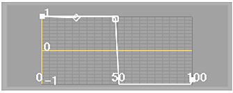

A positive polarity value attracts nearby points. A negative polarity value repels nearby points. The following example illustrates a magnet that has a strong positive polarity near the centre and strong negative polarity near the edges.
Magnet Curve Editor Result

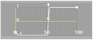

The following example illustrates a magnet that has a strong negative polarity near the centre and a strong positive polarity near the edges.

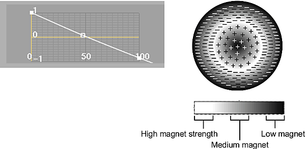

The following example illustrates a magnet whose positive polarity decreases from the centre and whose negative polarity increases toward the edges.

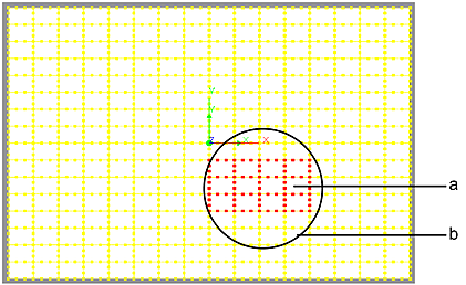

Use the invisible magnet to transform points you cannot select with the magnet. The centre of the magnet is determined by the centre of the selection and the radius is determined by the distance from the centre to the farthest selected point. Any transformations to the selected points are affected by the magnet.
To transform unselectable points:
  1. Use the Magnet Curve Editor to determine the polarity for the magnet.
  2. From the Tools drop-down, choose Select.
  3. Hold Ctrl and drag to select a range of points.
  4. In the Vertices or UV Points menu, enable Magnet.
    The magnet is not visible, but is illustrated here to show how the points will be affected when you transform them.
    (a) Selected Points (b) Magnet (not visible)
