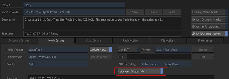

Apple ColorSync Compatibility Mode (QuickTime export)
In previous versions, QuickTime Rec.709 content could display a slight gamma shift when viewed in a macOS ColorSync-managed applications—QuickTime Player, Safari, or Final Cut Pro X. This is also known as the ColorSync-QuickTime NCLC tag issue.
To solve this issue, use the new Media Export option for QuickTime movie files. The new ColorSync Compatible button only applies to Rec.709 content and doesn't affect other color spaces: it is perfectly safe to keep it enabled when you export to other color spaces.
The export presets for QuickTime and Final Cut Pro have been updated to have ColorSync Compatibility enabled by default.
