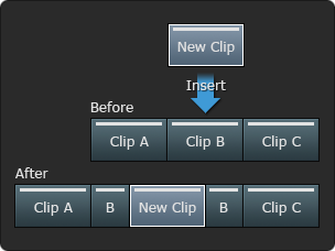

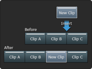

Depending where the positioner is placed, the clip is inserted, and the overall length of the timeline sequence is changed. The following example shows a New Clip inserted at the transition between Clip B and Clip C. Everything after the transition is moved ahead in order to make room for New Clip.
This example demonstrates the result of inserting New Clip at a frame in the middle of Clip B. Every frame after the edit point is moved ahead to accommodate New Clip.
