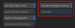

Metadata Overlay for Export
The Metadata Overlay can be burned into the image during an export. The option is available for File Sequence and Movie, but not for Sequence Publish.
To burn the Metadata Overlay on export:
  1. In the Media Export window, select Include Metadata Overlay .
  2. From the Metadata Overlay Selection box, select the overlay to burn on the exported media.
The Hardware and Software Anti-Aliasing values set in a Burn-In Metadata setup are applied on export.
Note: If you save an export preset, the status of Metadata Overlay is included in the export preset.
