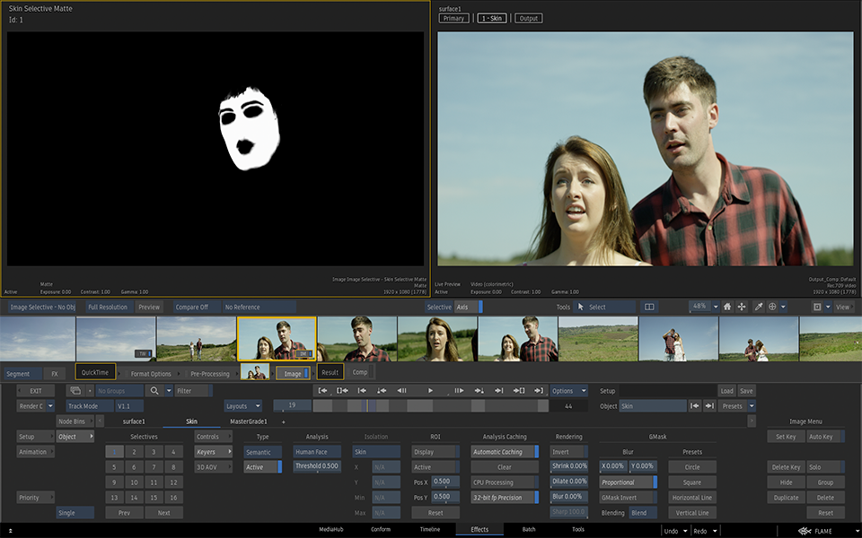

MLHumanFaceExtraction outputs matte coverage automatically based on a preset selection. The MLHumanFaceExtraction is also available as a semantic keyer in the Selective node available in Image and Action.
To create a matte from a facial feature:
- In Batch, connect a Matchbox node the media Front.
- Select the MLHumanFaceExtraction Matchbox and load it.
- In the Matchbox node, use Presets to select the feature to extract in a matte.
You can only isolate one human face at the time. If the shot contains more than one person, you must select the face to isolate.
To select the face to isolate:
In the Face Selection section, enable Icon.
Display the media Front.
Drag the icon over the face to isolate.
Animate the icon if the face moves out from under the icon over the length of the shot.
