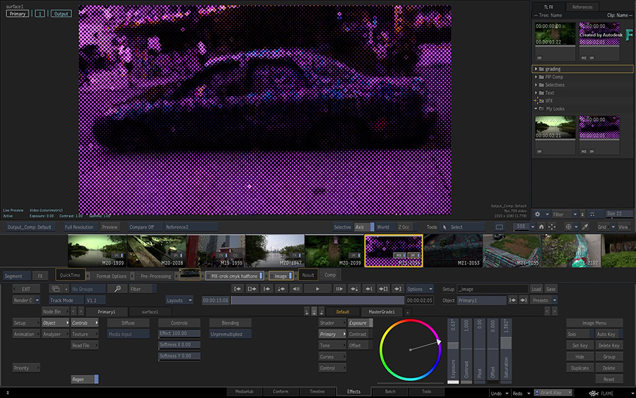

To display the Explorer, do one of the following:
  • Select Flame menu Show Explorer
  • Ctrl+swipe the side of the monitor opposite to the Media Panel.
  • Use the Windows+Esc (Rocky Linux) or Command-Esc (macOS) keyboard shortcut.
Note: Use the setting in the Media Panel Preferences to display the Explorer on the left or right side of the monitor.

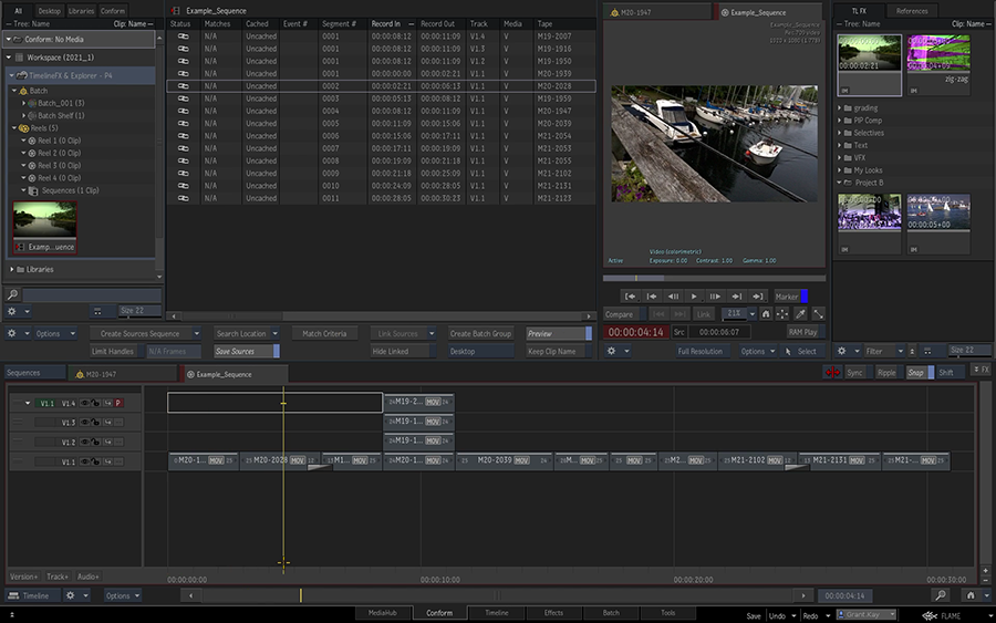

If you cannot display the Explorer:
  • In the Conform environment: You cannot have both the Preview window and the Explorer displayed at the same time. Click Preview to hide the Preview panel, or make sure the Media Panel is not displayed Full Height.
  • In the Timeline environment: Hide the Player panels, such as the Viewing or Scopes.
  • In the MediaHub environment: You can only access the Explorer when browsing archives or projects. Select Browsing for Projects or Browsing for Archives.

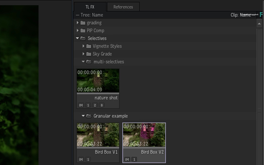

Working with Selectives
To store a specific Selective in the Explorer
  1. From the Selector, drag the selective to the TL FX tab of the Explorer.
    Tip: If the References tab is open instead of TL FX, hover with the clip over the TL FX tab to open it.
The Selective is a Timeline FX setup and displays the Image Timeline FX and the ID of the Selective.
To restore a Selective from the Explorer to a shot:
  1. Drag the Timeline FX setup with that Selective to the viewport, the Player, or onto the segment.
If the Selective you drop on the segment has an Selective ID already used by that segment, you get a dialog box asking you what to do:
  • Append: Add the dropped Selective to the segment by giving it the next available Selective ID.
  • Selective: Replace only the Selective with the dropped Selective. This replaces any keyers and GMask set for that Selective with those of the dropped Selective. Existing Matchboxes (including MasterGrade) are not changed.
  • Matchbox: Replace the Matchbox shaders of the original Selective with those from the dropped Selective, but preserve keyers and GMasks.
  • Replace All: Replace entirely the Selective with the dropped Selective, replacing keyers, GMasks, and Matchboxes.

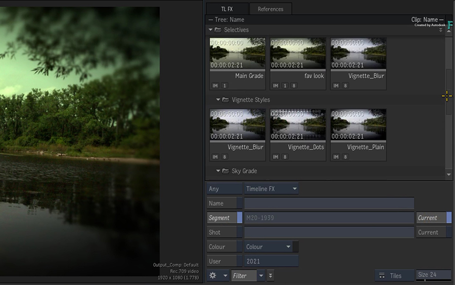

Filtering the Explorer Contents
Use the Filter button to display in the Explorer only Timeline FX presets and References matching the filters you select.
The Timeline FX tab and the References tab share the Name and Colour filters.
  1. To display the Explorer filters:
The filters are:
  • Timeline FX Type: One or multiple Timeline FX types can be selected from the drop-down button. Any / All lets you decide if the list of specified Timeline FX must match exactly all the Timeline FX of a setup.
  • Name: Name of a Timeline FX preset or a Reference.
  • Segment Name: Name of the segment the Timeline FX is originating from. A "Current" option can be used to automatically propagate the information of the currently selected clip to this field.
  • Tags: Tags given to a a Timeline FX preset or a Reference using the Panel's Tags feature.
  • Shot Name: Shot name of the clip the Timeline FX is originating from. A "Current" option can be used to automatically propagate the information of the currently selected clip to this field.
  • Colour: Colour given to a Timeline FX or Reference using the Panel's colour coding feature. Only the colours in use are available.
  • User: Name of the user who created the Timeline FX.
To filter the contents of the Explorer:
  1. Click Display/Hide Filters.
    When the filters are collapsed, the name of the active filters are displayed.
  2. Set the filters.
  3. Do one of the following:
    • Click Filter.
    • Press Space+E to toggle Filter on/off.
Tip: Create a Filter preset to make it easy to switch between filters. Use the Preset menu.
