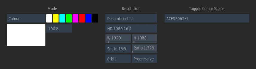

Source Mode option
Select whether to generate frames of solid colour, colour bar, noise, gradient, or STMap.
Select: To:

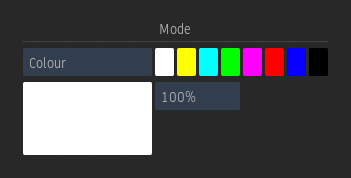

Colour Generate a solid colour clip.
Noise Generate a monochrome noise clip with a random pattern.
Colour Noise Generate a colour noise clip with a random pattern.

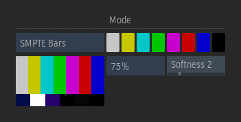

SMPTE Bars Generate a colour bar clip based on the SMPTE standard.
PAL Bars Generate a colour bar based on the PAL standard.

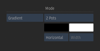

Gradient Generate an horizontal, vertical, circular, or 4-points gradient clip.
STMap Generate an STMap where the default pixel values for the red and green channels are set to 0.0,0.0 at the bottom left and 1.0,1.0 at the top right.
Luminance option
Select whether to apply 75% or 100% luminance to the colour frames.
Resolution Mode option
Select Resolution List for camera resolutions, Adaptive to set the width and height based on the Frame Aspect Ratio, or Scaling Presets for resolution fraction.
Resolution Presets option
Select a resolution. Select Custom Resolution to specify a non-standard resolution.
Adaptive Resolution option
With Width Based on Ratio, Width equals Height multiplied by Ratio. With Height Based on Ratio, Height equals Width divided by Ratio.
Scaling Presets option
Select a resolution as a fraction of the clip.
Width field
Sets the custom width resolution of the clip.
Height field
Sets the custom height resolution of the clip.
Aspect Ratio option
Select a standard frame aspect ratio. Select the Set to w:h option to set the clip to use square pixels. Select Custom to define a custom frame aspect ratio in the Aspect Ratio field.
Aspect Ratio field
Sets the custom render/output aspect ratio.
Bit Depth option
Select the render/output bit depth of clips.
Note: The 32-bit fp option is automatically chosen when you select the STMap option.
Scan Mode option
Select the scan mode of clips.
Tagged Colour Space option
Select a colour space to tag the result with.
Colour Settings
Current Colour
Set the solid colour. Click to open the Colour Picker.
Colour Bars Settings
Softness field
Sets the amount of softness to apply to the colour bar clip.
Gradient Settings
Gradient option
Select whether the gradient uses two or four colours.
Direction option
Select the direction for the two-colour gradient.
Circular option
Select whether the gradient circle is framed based on the width, height, or both.
