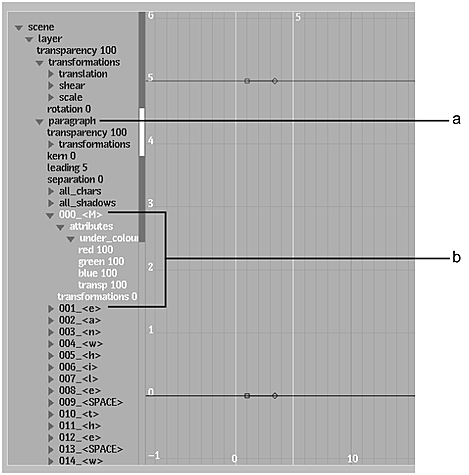

In the Text Tool, the Animation controls include a Paragraph Channel View for viewing text channels in the Animation editor. Use the attributes and transformation channels to animate paragraphs and characters and fine-tune animations created using the Attributes menu.
(a) Paragraph folder contains all the characters, including spaces between words (b) You can animate specific channels for each character
