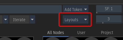

Quickly change the layout of the Batch tab using Layouts. You can create your own, or use one of the presets.
The Layouts drop-down box
The following elements of the Batch tab can be managed with a Layout:

To switch layout, do one of the following:
From the Layouts drop-down box, select a Layout.
Use the keyboard shortcut for that Layout.
The keyboard shortcut of a Layout is displayed in the Layouts drop-down box.
